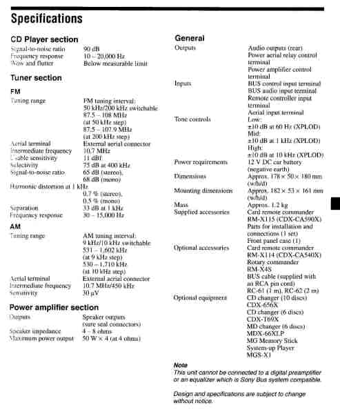

this is a pic of the hu specs. point out the gain if you will please.

From looking at the HU's spec, it doesn't list the pre-out voltage. So then you can assume it's 4v.
On the amp lot of them will say "gain", however, on your pic, I see one that says level and the other one is too blurry to see. Look at the min V number and the max v number. Try and find 4v setting. Where is the setting at right now on the Level? Just curious.
