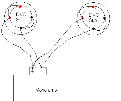

how do i wire my subs alpine type x's with 4 ohm dual voice coils down to one ohm on my 2 channel amp ive been trying to figure this out 4ever somebody help please!

wire each sub to 2 ohm. then wire the 2 subs to 1 ohm at the amp. check this iste out. it will explain it all. http://www.bcae1.com/defhome.htm

i no that but how?

how do u wire the amp down to one ohm one the amp?

heres a crappy Paint drawing for ya. you dont have to run both wires into the amp (like if they didnt fit or something). you can just splice 1 into the other.

oh but the amp isnt mono its two channel

I don't believe you will be able to get 1Ohm off that amp.
your best bet would to bridge the amp (if possible) and wire those subs to 4Ohm at the amp
