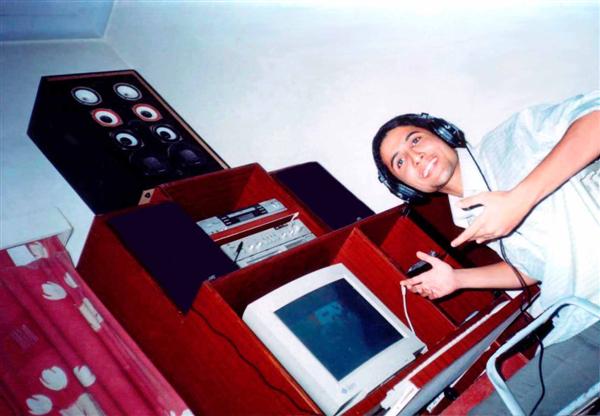

Nice photo by the way.
http://www.wickedcases.com/HT/index.html
that's mine at home. (HT, not the listening room.)
