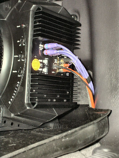

amplifier is built into the enclosure with the sub.
RCA and speaker level connectors are on the side of the enclosure.
this is the side of a basslink. note the power, ground, remote, and 4 RCA inputs:
