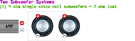

Wire each sub to it's own channel? I thought
Username: Oleg
Santa Monica, CA
Post Number: 115
Registered: Nov-04
Like that?
Username: Carguy
Post Number: 713
Registered: Nov-04
Okay, but your amp is 4 ohms bridged. You're making it into 2ohms bridged with that wiring. Unless you're talking about using only one channel?
