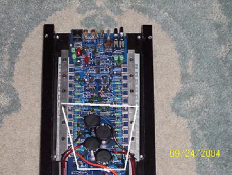

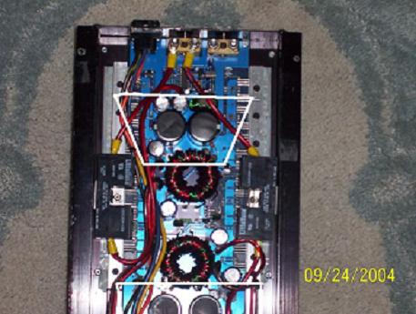

It blows the one side as soon as it gets power I hilited the parts that are in need of repair, the 450xtr has the crossovers that you can change inside the top
Username: Glasswolf
NorthWest, Michigan
Post Number: 6078
Registered: Dec-03
top image are your power supply capacitors
the bottom image are your FET rails for the amplification stage of the amp.
The trick to fixing those Orions is going to be finding the schematics for them listing the actual part numbers.
