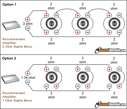

Wait a sec, if you have DVC 4ohms, then each sub can be made into 2 ohms by connecting it in parallel. So if you put three 2ohm subs in parallel, you should get around 1.5ohms.
So how are you getting .67 or 2.67? Just curious.
Help2
Unregistered guest
3 4 ohm DVC subs in parallel is .67 ohms.
3 4 ohm DVC subs in series/parallel is 2.67 ohms.
Username: Carguy
Post Number: 343
Registered: Nov-04
Okay I must be missing something in here. If you look at the pic above, option 2, it says 1.34ohms. So Help2, how do you get .67ohms using 3 4ohm DVC subs? According to the diagram, if you turn 4ohm dvc into 2ohms, and then connect them in parallel, you're suppose to get 1.34ohms. Is my logic way off?
Username: Stumped
Registered: Nov-04
the diagram shows 1.34...thats when u start off with 2 ohm subs. i dont have 2 ohm subs..
Username: Carguy
Post Number: 347
Registered: Nov-04
Ok now it makes sense. See what happens when you get all the facts :-)
