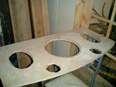

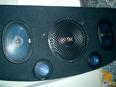

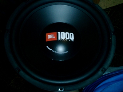

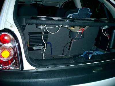

i have the mrp-m350 alpine amp and a 1000w 12"jbl i have the speaker sat on a shelf made of mdf me and a mate made i was wonderin if i could huck another 1000w jbl speaka to the amp and how thanks?

Hey Martyn, that'll depend on the amp. If it's 2 ohms stable, connect the subs in parallel mode. That is you wire the plus of one speaker to plus on the 2nd speaker, minus to minus. This will make the 4 ohms into 2 ohms. Now connect it to the amp.
Now if your subs are Dual Voice coil type, then connect each voice coil in parallel, plus to plus and minus to minus. This will make each speaker 2 ohms. Now you take both speakers and connect them in Series. That is connect one plus to minus of another speaker. Now use the opposite ends for plus and minus. This will make 2 ohms into 4 ohms for the amp.

yes its a nice lookin amp to and not that much ££££££ i have a question if anyone can help i got my jbl gt4-12" 1000w speaker on a parcel shelf i made and ive just built a box made out of mdf to seal off the back of the speaka will this make the bass sound tighter if anyone can help thans. :-)Upload
