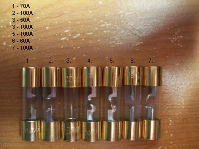

Here is a picture I just took of the 7 blown fuses. I have posed the numbers and how much A's there are in the picture.Upload
