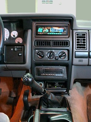

this is how I mounted the 3339 in the jeep.

The mounting is a bit of work since at the time I didn't have the pop-out DIN module for the face.
I had to grab a spare 4WD display unit from a junk yard, then gut it with a dremel to fit the faceplate, then fashion the fascia panel from ABS for it.. but it came out well enough.

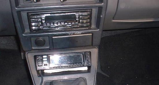

great story, I noticed tonight that the alpine 3342 is adding noise, if I turn the volume down on my sony headunit and the volume on the alpine to 0 as soon as I raise the 3342's volume 1 click I get noise, I guess I have to try to isolate where it's coming from first ( power, rca's) , when I first hooked it up I tied the power wire into the power lead for the headunit which is running off a fuse tap, as soon as I started the car I had the drilling noise, I moved the power for both the radio ( 12V constant only) and EQ to a line that runs directly off the battery ( which feeds my 2 amps) and that noise went away. This is where I was thinking of putting the 3342's control unit, I just have it wedged in there for now, it looks good there.Upload

try moving it's ground point. that's a common cause for ground loops.

ok, thanks, right now I have the radio and EQ grounds connected together going to the metal support for the center console ( below the radio, behind the pocket where the EQ is),

make sure it's a chassis ground by testing for continuity.
could try moving the +12 source as well.
its really just a matter of isolating the noise entry like you said
