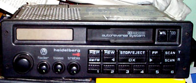

Username: Tucker73
'97 Jetta GLX
It worked for me.
I don't know who has what but this is a picture of my stereo on my stereo.
I got it to work for now.
1. "SAFE" apperars on the display.
2. Press & hold "MODE" button.
3. Press & hold "SCAN" button.
4. "1000" appears on the display.
5. Release both buttons immediately.
6. There should be a number to the left of the "1000" This should represent how many times you have tried to enter the code.
7. Enter your 3 or 4 digit code with the following. If you have a 3 digit code, assume that the first digit is a zero or blank.
8. Press button 1 until your first digit is changed to the correct number. (zero or blank)
9. Press button 2 until your 2nd digit is correct.
10. Do the same with the 3rd and 4th digit.
11. When the digits are correct, press & hold the "MODE" button.
12. Press & hold the "SCAN" }button.
13. The word "SAFE" should show up again.
14. Release the buttons immediately and your radio should work.

Yeah = start with radio off, hold in mode button, turn power on - it works when radio in safe mode.
Username: Dainty
Registered: Jan-09
Hey guys, so for 1997 Jetta go tru the same procedure:
1. Hold SCAN & MODE until 1000 appears
2. Enter the code
3. Hold SCAN & MODE again and the radio will just start playing.
I spent a year without knowing the code and today I saw that the previous owner had written it with pencil on the manual. Then non of the combinations that I found worked so I decided to try one of my own and Viola:-) good luck to all, I am so proud of myself:-)
