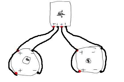

oh sorry for posting three times, eek, and I made another mistake, their 4 ohms DVC, can I do it now, and how? [IMG]http://img.photobucket.com/albums/v154/Rocksja/Untitled-1.jpg[/IMG]

Yes, with dual 4 ohm subs you can wire for a 1 ohm load. Do this:
http://www.crutchfieldadvisor.com/learningcenter/car/subwoofers_wiring.html?subs =2&impedance=DVC4x2
And do the 1 ohm load option. You can wire one sub to each terminal of your amp saying your amp has two terminals (for convenience purposes, it's still mono and presents a 1 ohm load).

I know, but please, I'm gonna try to do it myself, and don't really get it, so if anyone can please connect the dots to the pic? please? yeah I'm that clueless? http://img.photobucket.com/albums/v154/Rocksja/Untitled-1.jpg

Here ya go:
The black is just regular speaker wire.

Thanks, so it's not nessary to just set both subs into one terminal, THANKS Jonathan!

800 watts total, 400 to each sub, the power divides between the two. You wire the same way as drawn above, only difference is your amp likely has one terminal instead of two (there's no difference, the 2nd terminal is just for convenience).

Jonathan i got a similar problem see if you can help me i have a jbl1200.1 and two rockford fosgate12" 500 rms dvc 4ohm subs right know i have them wired like this, I have 1 speaker wired in parallel for 2ohm and the other one wired in parallel also. since the jbl has 2 channels or inputs + - + - i put both of them in their separate inputs. Did I wire them right? Thanks for your help.

Yep. Those two inputs are solely there for wiring convenience, it's the same as putting both subs on one terminal.
