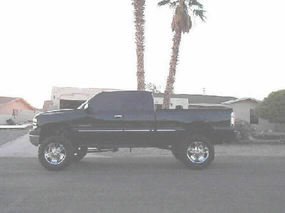

Hey, do you have e-mail or AIM ? I have the truck you have and I would like to know about your enclosure, where you got it from, what it looks like ... where you got those handles ... and other stuff

That's the link to the enclosure I got for my truck. There's alot of companies that sell them on the internet and ebay, but you gotta pay attention to what size mdf wood they use, and also differnt mounting depths, and cu.ft air space per chamber. This is the best one I found so far. The handles for my truck I can't remember where I got them, i know i got them off the internet because they were shipped to me, either ebay or from a site. I just got my K&N intake off ebay also. In the past I bought my billet grill, altezza taillights, clear corner lenses and all hyper white bulbs.. and other stuff I'm sure for great prices off ebay and the internet. Way better prices then the speed shop in town, that's for sure.
