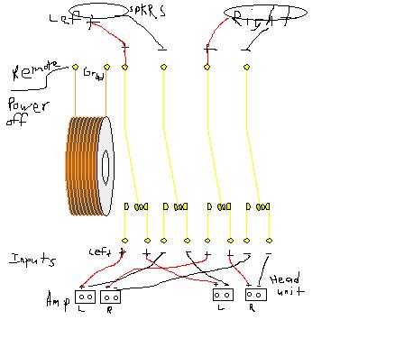

I want to hook up an amp to power my full range 6*9's on my rear deck, but want to be able to switch the amp off with a simple toggle switch in the remote turn on lead which will then leave the speakers powered by the head unit... can I leave the speakers wired to the head unit and connect an amp that will sometimes be on without doing too much damage? Or am I going to need to create some kind of ellaborate swtching mechanism that cuts the head units power to the speakers when the amp is on? If the latter is required, any recomendations would be appreciated....

It's a 99 hyundai Elantra GLS, I have an Aiwa head unit and some JBL 3 way 6*9's in the back, the amp I have laying around is junky and old, but it will cost me nothing and put out more power then they are getting now it's an Advent 4x50watt (rms I think) bridgeable to 2 channels which is how I'll run it. Hooking up the amp is the easy part I've got it all run allready from previously stolen set ups... my concern is making the amp not function at the flip of a switch, and having the radio power the speakers after that flip... I figure a relay setup powered by the amp turn on remote lead will work I've just never used them and don't have much knowledge in that realm.... toggle switch on the remote line gives/cuts power to the relay(s) (I'd love to be able to use just one)...when relay is powered it switches the the speaker inputs from the head unit to the amp, when power is cut (via the simple toggle) the relays switch back and the speakers get input from the head unit...
I know it will work, does anyone have any suggestions on type of relay that will cause the least loss/interference, know of any other concerns, or have any suggestions about my proposed set up?

Well, now that I've done some reading it doesn't seem like rocket science.... now if only I can find a 4PDT 12V DC 30A relay (and socket)

That relay just seems like a lot of work for nothing IMO, but anyway, I think it'd be easier to hook up toggle switches. Use a double pole double throw slider switch (one for L channel and one for R), then run the pos of the head unit to one terminal and the pos of the amp through another, then wire the center pole to the speaker terminal. A double pole double throw slider switch allows you to control two different circuits(when one is on, the other is off), basically, and has 3 positions. Then use a single throw switch to control the remote wire. Much simpler than diodes and still easy to use.

Problem is, from my understanding is that the circuit must be broken between the amp & the speaker or Head Unit and the speakers, at any given time. If I were to use toggles, they'd have to be trunk mounted or I'd have to run wires all over the place... with the relay (sitting in the trunk) I get to utilize wiring that's allready run, the remote turn on lead, and just splice a toggle in it somwhere up front. The remote line with the toggle set to "on" then powers the relay which opens the circuit between the head unit and the speakers and closes the circuit between the amp and the speakers, the reverse of course happens when the toggle is switched to off.
My idea protects both components, I now just need to get the part(s) preferably a 4 pole Dual Throw Relay rated for 12V & 30A anyone know where I can find that?

Well, it's just one wire(pos) from each side of the amp, but your relay idea up top will work. My idea isolates both as well. I just figured since you're gonna already have a toggle for the remote wire, two more wouldn't really be an issue. As far as the relay, a google search will land you one. http://www.bcae1.com/switches.htm
This explains a double pole double throw. It's either one or the other, it would perform the same as the relay.

I've been googling my relay for hours.... unfortunately I can't find a single relay to do what I want, I'll have to use 2 DPDT relays... not a hug issue but I would have preffered just one.
Relay's aren't actually difficult to hook up and I'd recomend them to anyone installing a external cooling fan, or other device that you'd want turned on with your amp rather then ruining a nice looking dash or console with switches everywhere.

Getting the amp to turn off is no big deal. The trick is cutting the connection between the h/u and the speakers. If thats not done and the amp is turned on you run the risk of frying the outputs on your h/u. I'd make sure that my system was idiot proof or be ready to explain to your better half the copious amount of smoke emanating from the cd slot.

No, relays aren't that hard to hook up, but it's a more complicated circuit than the switches would be. And when dealing with audio, the simpler the better. Relays will have an internal resistance (of course switches will too, but less so) that will add to total impedance. I don't really know any online sites carrying relays, I get them at work (I don't really use them in car audio, but if I ever need them...)

I decided that my above schematic was correct and would have worked just dandy, so I don't need to go through with actually doing it, it was fun to puzzle out though and now I know about relays woo hoo...
