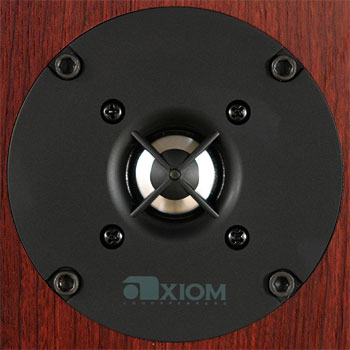

Axiom Tweeter
Modern Marvel
All of us take for granted lots of modern marvels, but it nevertheless still impressed me in that instant that a tiny reciprocating electro-mechanical motor-- the voice coil of the Axiom M22 tweeter--moves a titanium dome back and forth 10,000 times per second to precisely reproduce that convincing triangle sound. (The triangle is an instrument of indefinite pitch but the bulk of its output is centered around 10,000 Hz.)

Why titanium and not silk or cloth for the tweeter dome, you might wonder? Isn't cloth or silk inherently softer than metal, hence better suited to reproduce music? This touches on a common misunderstanding of loudspeaker design, especially of tweeters, by some professional reviewers and lots of enthusiasts. They believe that a hard dome material imparts a "hard" or harsh quality to the sound, or conversely, a "soft-dome" tweeter made of cloth or silk will yield "soft" or "silken" traits to strings and other sounds. This is nonsense, based on lack of knowledge of how a tweeter dome operates.
It is not the material the dome is made of that imparts so-called musical qualities to loudspeaker sound reproduction; it is the linearity or accuracy at which the dome precisely vibrates, without distortion, to recreate the waveform of the triangle that convinces us of a triangle's sound. The lighter the dome is, the less energy it takes for the voice coil to easily move it back and forth, stopping and starting its travel as the voltage moves between positive and negative cycles. Ideally, a tweeter dome should exhibit perfect pistonic motion during its rapid back-and-forth excursions. The dome must be rigid and not change shape during these rapid fluctuations. Titanium is ideal -- light yet rigid--and functions as a heat sink to drain heat away from the tweeter voice coil during loud dynamic swings in the music. If cloth or silk doped with a stiffener were used to shape it into a dome (still used on many speakers) or polypropylene (plastic) material, it might be less rigid and could change shape, especially from overheating, which would alter the accuracy of the reproduced waveform just a little, perhaps enough that the triangle sound might not have that lovely ring. During a recent double blind listening test of a competitor's speaker, I described the treble and midrange as "shrill" and "screechy." The tweeter was a cloth-dome design, so if the material made any difference, it should have sounded "soft," correct?
In fact, it was the jagged and unbalanced frequency response of the competitor's speaker that made it sound shrill, not the cone or dome materials. Over many years of double-blind listening tests both at Axiom and at the National Research Council in Ottawa, I've heard speakers that used a variety of different materials for the tweeter dome. Some cloth or silk dome tweeters exhibited edgy aggressive highs, but when the tests were over, you could quickly spot the jagged, unbalanced treble frequency response in the measured curves that was responsible. Similarly, I've praised some speakers that used aluminum and metal-dome tweeters very highly and downgraded others. It's all about smooth balanced frequency response free of jagged nasty resonances, not about the driver dome or cone materials.
Getting Loud
What happens inside a tweeter when the music gets loud? When a big cymbal crash comes along, a bigger voltage hits the voice coil and it momentarily heats up, but the Axiom titanium dome helps conduct heat away from the voice coil. Moreover, the voice coil is immersed in a bath of magnetic ferrofluid to help move heat away from the vibrating voice coil (ferrofluid has the ability to increase heat transfer from seven to ten times that of air). This is one reason why Axiom tweeters can cleanly reproduce very high-volume sound and cleanly handle dynamic peaks.
