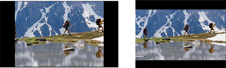

Aspect Ratio
The screen shot on the left shows how a projector with a native 16:9 imager displays a 4:3 image. On the right, a 16:9 image as displayed by an older 4:3 native projector.
All of our projectors can display both 4:3 and widescreen 16:9 material. All use an imaging device with a 16:9 "native aspect ratio," which means that all pixels display when showing widescreen signals, but showing 4:3 material causes pixels on the sides to shut off, so you'll see vertical black bars on each side. See our article about aspect ratio for more info.
