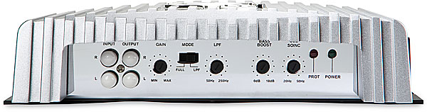

Tip #8: Set your amp gains properly.
Our Product Support people field calls every day from customers who can't understand why their new car audio system sounds so bad. The #1 problem? Most people think the gain control on their new amplifier controls the volume level. Naturally, they turn it all the way up and then bad things happen. The gain control actually adjusts the amount of input signal coming into the amplifier. Crank it up too high, you'll hear some nasty distortion.
MA Audio Amplifier
Set the gain control on this MA Audio amplifier properly, and you'll keep distortion out of your system.
The general idea is to turn your receiver's volume control roughly 3/4 of the way up to maximum volume, then turn up your amp gain until you hear distortion. Back it off a little, and you're all set. Every amp manufacturer will have specific suggestions, so you'll want to check out your manual for the best way to set the gain on your new amplifier.
Learn more about setting up your new amp.
