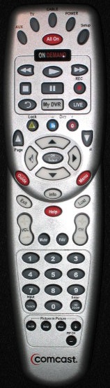

remote
Instructions:
  1. Press the "Cable" button at the top of the remote to put it into Cable Box control mode
  2. Press and hold the "Setup" button until the "Cable" button blinks twice
  3. Enter the code 994 from the keypad (the "Cable" button should blink twice)
  4. Press (do not hold) the "Setup" button
  5. Enter the code 00173 (for 30 second Skip)
  6. Press any button you want to map the skip (e.g. the "A" Lock button)
  7. If successful, the "Cable" button will blink twice
