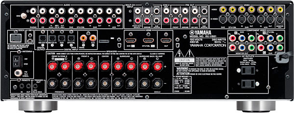

Back-Panel
All receivers should have inputs for the full range of video connectors -- composite, S-video, component video, and HDMI. With the popularity and standardization of HDMI, the clunkier DVI inputs have largely disappeared. If you have an older DVD upconverting player with only a DVI output, you can get a DVI/HDMI adaptor. With increasing price, the number and variety of inputs and outputs, especially HDMI, increases. The over-$1,000 models typically feature three or more HDMI inputs, and plenty of analog and digital inputs and outputs, both optical and (less commonly) coaxial.
Entry-level AV receivers may offer only simple HDMI switching of connected components but you'll want to make sure that whichever AV receiver you choose, the HDMI "version" is compatible with your HDTV's input and with any upcoming purchase of HDMI-equipped components such as a Blu-ray player or gaming system. The latest HDMI version is 1.3, but earlier versions will carry many of the high-resolution audio formats.
If you anticipate getting a separate power amplifier with much greater power output in the future, then make sure the AV receiver has "pre-outs" (preamplifier output jacks) for all channels.
