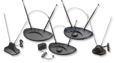

- Television stations broadcasting in digital use both the VHF band (channels 2-13) and UHF band (channels 14-51). Many indoor antennas use “rabbit ears” for the VHF band and a “loop” or “bow-tie” antenna for the UHF band. Make sure you are using an antenna that covers both the VHF and UHF bands and have connected it properly.
- Simple indoor antennas, such as rabbit ears, provide minimal performance that may or may not be suitable for your location. If you are unable to obtain satisfactory reception with your current indoor antenna, you may wish to obtain an indoor antenna that includes features for better reception of UHF signals and/or an amplifier to boost the received signal (often referred to as an active indoor antenna).
