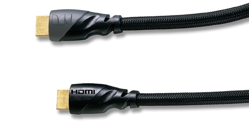

11. Q. With all these digital audio and video capabilities, are HDMI cable lengths really critical?
A. Yes. Actually, the thickness of the internal wires-the cable gauge-matters just like with analog speaker cables. For example, if the HDMI cable's internal wires are 28 gauge, then you can run up to 16 feet or 5 metres. More robust cables with thicker 24-gauge wires will operate up to 39 or 49 feet (12 to 15 metres). Note that the given figures are for ideal conditions. Many cables will not transmit over these lengths. For very long cable runs, there are alternatives like CAT-5 cables that can extend HDMI to lengths of 300 feet or more.
cables
