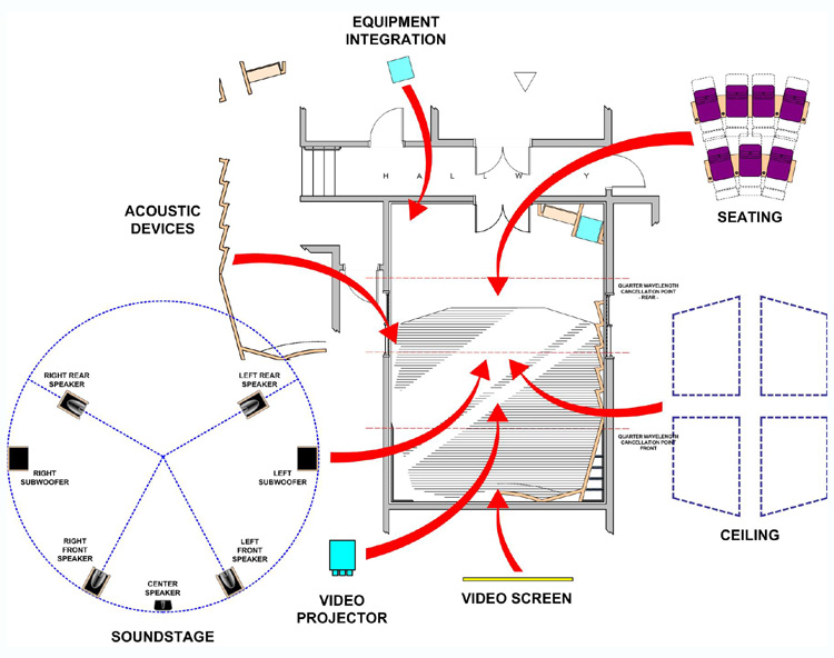

If it is of existing construction, we take drawings from the client and put them into our CAD system. We send jpeg or other suitable drawings back to the client/dealer to verify that we have the correct dimensions put in our system. This drawing should be verified by the client/dealer/contractor to insure that dimensions are accurate.
In the case of new construction, where we may have some flexibility in the dimensions, we do a dimensional analysis to determine what dimensions are best for the space our client has available. We also have to take into account the physical area of the space that is available and weigh it against the number of seats the client wants. Often, as might be expected, compromises have to be made. For example, a client may want more seats than a room really should have, which may compromise the sound quality for the rear row of seating. See "Room Size" diagram. This shows the appropriate amount of space required. In a perfect situation, you would like to have the listeners at least 3.5 feet away from any adjacent wall. Not doing so will mean that they will experience low frequency gain above 40 Hz from being too close to the wall, due to boundary wall loading effects. Also, the distance to the screen is important. For a projector that runs at 1080p, the nearest seat should have a viewing angle of no greater than 36 degrees. This will insure that they cannot resolve individual pixels. For an 8-foot wide screen, this works out to be a viewing distance of a little over 12 feet. Then, on top of all of these criteria, you should pick dimensions that have good modal distribution. We want to support as many room modes as possible in the low frequencies without having axial modes that are close to each other. When the latter happens we will get certain frequencies that are accentuated and create that "boomy" and muddy bass sound.
This whole process can be iterative as there may be some tweaking to insure it works into the rest of the architectural plan. We work with the client and architect until we are all in agreement as to the dimensions. This is an extremely critical phase of the project. Dimensions are one of the most important aspects of good low frequency sound reproduction, and they are not easily changed once built. So the moral is-get this right and listen to your designer/engineer. If they warn you of problems, listen carefully and ask them what problems and how severe. They should know where the problems will exist and have a rough estimate of the severity, but the severity is often difficult to predict precisely prior to building.

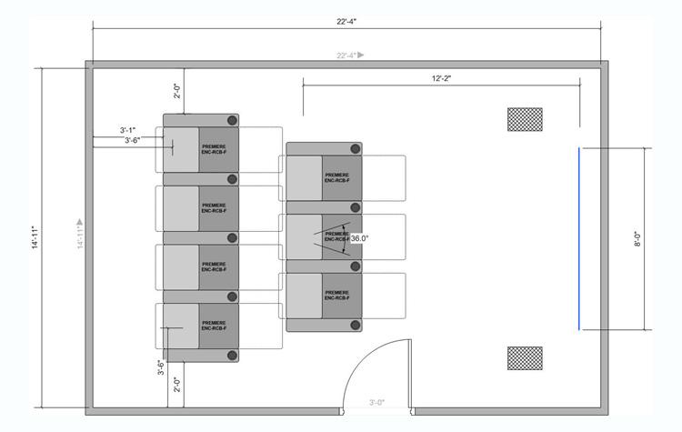

This phase is to insure that the ergonomics, or space use, of the room are correct. For new construction, we have to consider where the entryways and windows will be. For both new and existing rooms, this is the point where we determine the approximate speaker, screen, and seating locations, including how many seats, if there are risers, and any other basic ergonomic issues. Again, this is an iterative process to insure we meet all of the clients' needs. Once this is approved, we move on to the concept plan.
This sounds like a really simple phase of the project, but often it can get complex very fast. For example, someone can say he or she wants 12 people in a room that measures 14 x 19. Well, you can fit that many chairs in the room, but both the visual and sound will be severely compromised if you do this. Some of this process may have been taken care of in the dimension phase, but in this phase it should be refined. A good designer will lay out the room and show the requested number of seats, and then design another layout that would be optimized to show how many potential problems might be addressed and corrected. We run into this issue a lot, and show our clients what it does for the overall sound and visual issues (people too close to the screen who can see individual pixels—not a good idea). Once they can visualize the problems, they generally back off and say something like, "well, can we get 8 people in the room, even if 2 of them get bad sound?" Or sometimes we go from theater style seats, which take up a lot of room, to more casual couch style seating. There are many ways to incorporate compromise when striving to achieve the goals of the client, but again it's very important to really communicate with the designer/engineer. It's ultimately your room and they need to fully understand what is most important to you.

The concept plan adds the basic acoustical treatment into the room. This calls out all the surface treatments, floor type, ceiling construction, absorption, diffusion, and trapping within the room. It will also give a good idea of what the room will look like from a 2-D plan view. In addition, the concept plan is a good time to be considering budgets as well as aesthetics. Different treatments have different building costs associated with them, and while we can not know precisely what a contractor might charge, we do know how to trim costs. The caveat is that it is usually at the expense of either aesthetics or sonic benefits of the room. Once this phase is approved, we move to the schematic phase.

The schematics have floor plans, together with all the details and assembly drawings, and often elevations where applicable. These are the details required to build the room. Also during the schematic process we verify the preliminary work done in the concept phase, and insure that we have the right amount of absorption, diffusion, and trapping, so there are likely some small modifications made from the concept plan, but they are relatively insignificant to the client.
The schematics complete the design phase. These can be given to a contractor(s) to bid on the project. Most contractors have never seen an acoustically engineered room before. That's okay—don't panic (yet). If your contractor doesn't ask, and doesn't call the engineer and designer to inquire, about some aspects of the design, you're in trouble. Don't hire that contractor, pick a different one. Then call the designer and get his opinion on the questions that were asked. Were they good questions? Did the contractor seem to have the right idea and perspective on the project? Your designer can be very important here because he will likely be communicating with your builder during the construction phase. Listen to him, and don't necessarily pick the lowest bid.
