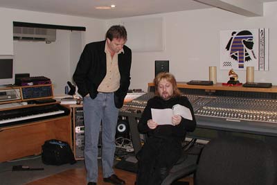

Aldo Nova (seated) and Ian Colquhoun in Aldo's recording studio. Aldo has the M2s, M3s and M22s in his studio. Axiom speakers were also the reference speakers at the world famous Le Studio, north of Montreal.
