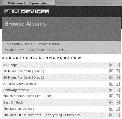

Now that you have a static IP address thanks to DynDNS.org, you can access your music from any web-enabled computer. To do so, simply go to a web browser, enter the URL you signed up with at DynDNS.org, and add the port number to the end of the colon. Your URL should look something like this: whateveralias.net:9000. If everything is working, you should see a SlimDevices web page similar to Figure 6-3.
Figure 6-3. Your music on the Web via Slim Devices
This web page is being served by the computer on which you installed SlimServer. You can now browse and play all your iTunes playlists and songs from a remote machine.
