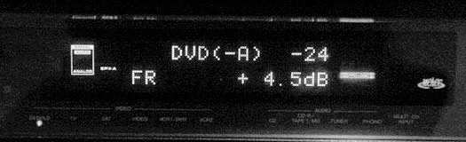

The range of allowed adjustments usually goes from -10 to +10dB, with zero being the default volume. Figure 8-2 shows a Pioneer receiver's face, with the front-left speaker level being modified.
Figure 8-2. Speaker levels being modified

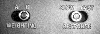

Set your meter to "slow" response and the weighting to the setting suggested by the calibration test you're using (both VE and Avia offer on-screen instructions on proper meter settings). Most calibration tests suggest a "C" weighting (as seen in Figure 8-3).
Figure 8-3. SPL meter weighting and response settings
