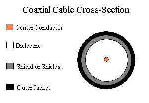

Most video cable (leaving out of this discussion the parallel digital video standards, DVI and HDMI) is coaxial cable. Most people associate the term "coaxial cable," or its nickname, "coax," with RF video cables used for CATV distribution, or with coaxial digital audio cable used in handling SPDIF signals, but the fact is that "coax" is the basic design for every common analog video standard, whether it's RF, composite, s-video, component, RGB, or SDI. While the cables used in these applications may differ from one another in a variety of ways, they're all coax, and are all designed and produced in more or less the same way.
When you're trying to learn something about a particular manufacturer's video cable, there are really only four physical components to consider, and how those four components are built and interact accounts for everything a coaxial video cable does and for whether it does it well or poorly. These four physical components are all, in a straight run of cable, cylindrical in shape--because they share a common physical axis, which is what makes a cable "coaxial." These, in order from the inside to the outside, are the center conductor, the dielectric, the shield, and the jacket. If you cut through a piece of coaxial cable, you'll see them, laid out as in the drawing at right.
So, let's dissect this cable; we'll talk here about what job each of these four components does, and what kinds of materials and configurations they're commonly found in, and the advantages and disadvantages of different materials and constructions.
