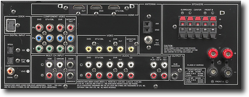

ok im going to try to hook up the ps3 to AV receiver then AV receiver to TV here is the model number of my receiver
yamaha (this the back)
RX-V363BL Upload

Scott,
According to the manual for your reciever you'll have to make a separate digital audio connection along with the HDMI. Your receiver will not pickup the audio from an HDMI input.
With you PS3 you'll need to use an Optical Digital cable.
Matt @ OneCall

ok i will go get a digital optical cable to see if that will work. thanks for all your help.
Username: Ak_dude
Anchorage, Alaska
Registered: Jan-09
ok that solved the problem thanks for the help everyone.
