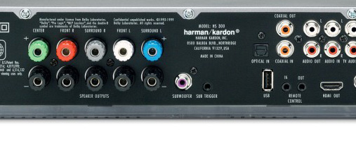

If you look at the back of the HK receiver / DVD unit, you see the standard subwoofer connector…
Does anyone have any recommendations for another system like the HK or a receiver that is really thin? I have a maximum of 4.5” of clearance.

Sorry, I was incorrect, the Bose bass module for the Acoustimass 10 is powered so the HK would work. When you mentioned that the previous owner took the receiver I was thinking it was also Bose. So is there any way to find out what he was using? Your clearance issue will certainly limit your choices.
