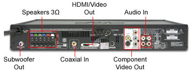

Thanx for the advice! However, I did run into another problem, I just realized that my HDTV only has one optical output (no coaxil) while the receiver has only a coaxil input (no optical)! Wish I would have realized this before I bought this cheap receiver. What I have done is run RCA audio cables from the TV to the receiver and then run the coaxil from the Blu ray to the receiver since that is what I use to watch most of my movies. It sounds like I am getting some form of 5.1 surround from the TV eventhough I am using RCA cables- Is that possible? I thought that RCA cables were stereo only. I did notice a big difference in the quality of the surround coming from the Blu ray which is connected directly to the receiver via coaxil (which sounds awesome now that I have it on the right listening mode- thanks Jeff)and my other devices that are connected to the TV via HDMI and then the receiver via RCA cables. I guess I just want to make sure I have it set up the best way possible with the limited hardware (cheap RCA receiver) that I have. Here is the back of my receiverUpload

The RCA audio cables are providing a 5.1 analog signal while the coax is 5.1 digital.
I would say, for this particular receiver that you are all set. Sit back and enjoy!!!!
Without meaning to sound critical, if there is any chance that you can swap your RCA HTiB for a Panasonic one I think you would find it more compatible with your TV but if not, as stated ENJOY!!

Someone tell me if I am wrong but the optical out put on the TV is "only" for the built in HD tuner in the TV and will not act as a switching station for any sound or device that you connect to the TV via HDMI. Using the Coaxial input on the receiver for the blu-ray is the best possible way to get Dolby Digital or DTS surround sound. Using the red and white analog RCA inputs will give you surround sound but only Pro Logic. Since you only have the one coaxial input you could manually switch it from blu-ray to HD-DVD and the cable box depending on the source you are using at any given time. I would put the cable box in the RCA and live with Pro Logic for TV and use the coaxial for the blu-ray and manually switch it for the occasional HD-DVD.
