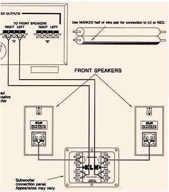

Alex, if you get a sub to work with this amp, make sure you get one with speaker level hookups. The back panel would look something like this:
Note the terminals for speaker wire hook up. You would hook it up like this:
Depending on where the crossover is set, the sub would separate out its operating frequency without draining the power going out to the main speakers. This way, the sub would reproduce the bass signal from both channels. And it would still use its built-in amplifier to power the subwoofer's speaker.
Username: Vt_ahole
Post Number: 67
ok thanks a lot! the picture really helped.

Yes Alex, that Sony sub can be hooked up the same way. Just follow the diagram in the installation intructions that come with it.
