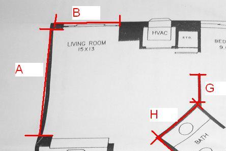

Just moved into a new condo and am trying to figure out how to set my my onkyo 6.1 system. I attached an image of the layout. Right now the 42inch plasma is on an enertainment center on wall G (living room side- see drawing)...
The issue I'm having is wiring speakers. I could have cable run the long way, but am also looking at a wireless rear speaker setup.
Are there wireless rear speaker options for 3 rear speakers? Other ideas?

This is a tough room for surround sound. If the TV is on wall G where do th front left and right speakers go. What is wall B (sliding glass door)? Possible solution is a corner set up between wall H and G or just turn your original idea around and put the TV on wall A. But wall G is a bad choice.
