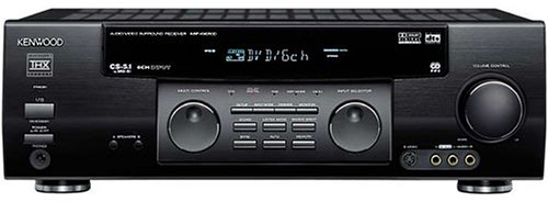

Many thanks. I wonder if you would mind identifying your receiver?
50 Hz on the main speakers is borderline. The effect I heard was with speakers at 40 Hz - 3dB cutoff.
The other cure for my Dolby megbass effect was to connect the sub at speaker level, not line level. If I go back to using a sub, this is what I shall do. My current speakers go to 35 Hz and I really think a sub is low priority in this case. Even 50 Hz could be regarded as full-range. 85 Hz (as many home cinema speakers) and a sub is much more likely to improve things.
Username: Thx_3417
Post Number: 932
Registered: May-05
It’s a Kenwood KRF-X9050D THX select model, yes she is around 5 years old and still able to give the best sound at an affordable cost…
