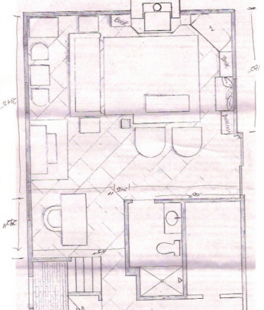

I am setting up family room system, want to go with speakers for both video/audio type setup. I am considering a Pioneer vsx-84txsi receiver, and want to match up speakers that would fit well. I saw a few write-ups on the paradigm 330's with ultracube.Saw some nice Kef setups too but had some doubts about the tweeter location. Maybe these are too light for this newsgroup? room is 25'x20' 7' ceiling. I was thinking about $1500 for receiver and about $2000-2500 for speakers-will need 2 fronts, 2 surr/at least two rears because of the shape of room, and a good(relative) sub. I already have the sony in a box thing, and am looking to upgrade from that, although I cant afford the Macs and the Meridians. I just realized I can upload an image. I cant use wall speakers on the outside walls, which hopefully are clear, unless they are in wall, with some kind of soundproofing/anti-vibration system around them. Please notice the square oin the middle is a center post, just under 12" square. I greatly appreciate all of your help and suggestions. thanks

Looking at your diagram, I had another idea. Have you thought of "in-ceiling" speakers for your rears? Inasmuch as you have your tv in the corner, it makes placement of your rear speakers somewhat problematic. since you have 7' ceilings (not too high), some good self-contained in ceiling speakers may be right for your situation. Here is a link for some very fine, reasonably priced in ceiling speakers from Monitor Audio that are self-contained (inside their own enclosure):
