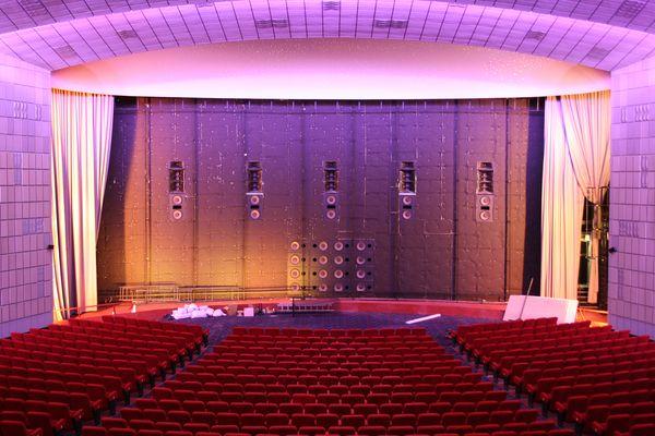

The professional version is totally different the home cinema application sure good room acoustics but unless you have a few feet of concrete to keep outside sound pressures from getting in and from getting outside the room forget that part I’d say only a few have got good isolation noise background levels.
Also most that do my not have the loudspeakers properly addressed with active cross over frequency dividing networks for LF and HF over the matching front loudspeakers Left centre and right. I doubt some have even considered placing the fronts along with the sub bass in baffle wall of THX baffle wall that is covered over with high frequency absorbent material, this will reinforce the sub bass and bass while keep reflections off the front wall, or best when used with a perforated screen for use with video projector reflections would bounce off the screen and then onto the untreated wall thus making it sound harsh.
As for the rest of circuitry that deals with timber balancing between fronts and backs when sound is panned from the front say a helicopter flyover in the opening of “Grand Canyon” Dolby 3.1 mix that’s right left centre right and one single monaural surround sounds great when you’ve got a good THX set-up.

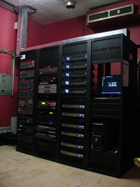

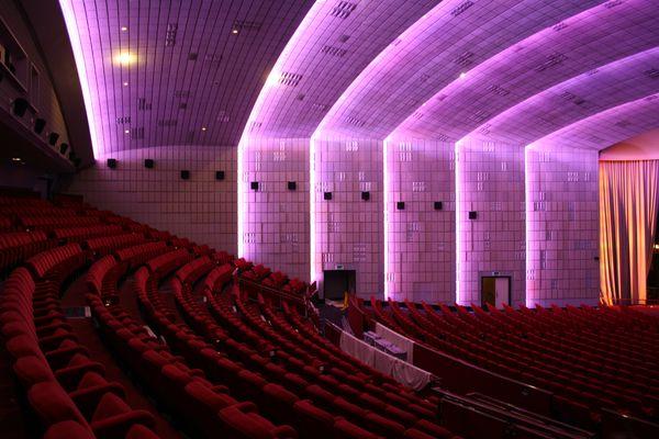

And how in the world can it be confusing its been around in the cinema since 1983 check out some of the best sounding THX screens or pop on over to the United Kingdom we have the most powerful THX screen in the whole of Europe anywhere. 56KW that’s right 56KW and JBL sound system that would have you drooling for months on end!
