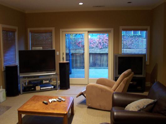

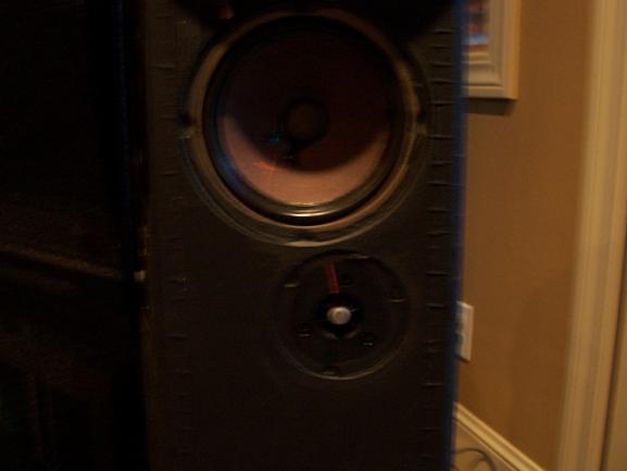

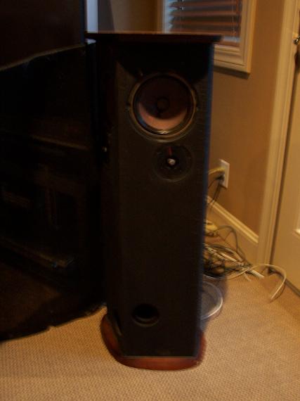

Username: Tunasalad
California
US
Post Number: 47
Registered: Dec-05
Well, I went to my local high end electronics store and got some things done. First, the guy there said that any new (even pretty low end) DVD player will get me a better picture quality than the crappy Panasonic that I have now. Also, as David just touched on, he recommended that I search for a 12, 14, or 16 bit processor in the player to get the best quality. So, I will continue to search for a DVD player that fits my needs here. The good news is, I have seen light at the end of the tunnel in my search for an A/V receiver. The Onkyo TX-SR804 looks absolutely perfect in terms of the features and fairly minor points. The two reasons that I didn't buy one already are that, while CNET did discuss the HDMI video quality of the SR674, they didn't discuss the 804 as much. The second, and probably more important, thing is the THX 2 certification. The reason that this is an issue is that I might power the two fronts off an external amplifier in the very near future (in order to imcorporate my HIFI stereo pre amps and such). Now, what I would like to know is, even with me powering these speakers off an external stereo amp, is the THX certification worth the extra $100-150 (because the SR674 is the same thing, except with less power and no THX)?
Secondly, and this is closely related to the first part of this post and Berny's last post, in the event that all this upgrading gets approved by the people with the money (not me), I am going to get a higher end center ($100-225). I asked the guy at my local shop and he asked me about my current L/R's. I told him that they are DCM TIMEWINDOWS and he told me that they are out of buisness, which I already suspected. So, now I have to find out about my L/R's impedance and the type of tweeters and that sort of thing. Either way, he showed some $200 or so B&W piece that he claims, with a good receiver will give me a night and day difference. (As a side note, do you guys agree with that assertion?) I am mentioning this because it relates to the THX certification of the receiver. By the way, the 804(the one I would get) has 105wpc power. So, factoring in all this, is the THX certification worth anything, and if it is, do I even need the stereo power amplifier and would the THX have an effect on the new (hopefully) center channel.
Any and all insight from anyone is apprectiated, I also would welcome unorthodox solutions, just cause they are interesting,
Thanks, Stefan
(P.S.)
Some pictures of my HT and Right speaker, if anyone knows what kind of tweeter that is at a glance, I would love to know
Username: Project6
Post Number: 12567
Registered: Dec-03
Check this out.
http://www.dcmspeakers.com/heritage.htm
I would not get too excited with an Onkyo to power those particular speakers. Onkyo has weak power supplies and I tend to exclude them from any recommendation. You will hear or rather...not hear the inadequacies when playing a particularly complicated piece. An HDMI capability is not a good basis for a great receiver, convenient, yes, but until it is standardized, reconsider your purchase.
You have a great speaker system, it would be a shame if you cannot use them to it's full potential.
A THX certification is nothing special. It is just a set of parameters that certain equipment is supposed to be able to do. Any decent equipment worthy of its weight will certainly meet and exceed these parameters. And yes, you are paying extra for that logo, unnecessarily.
Again I would advise strongly against buying a receiver that wows you with it's video capabilities and extraneous features.
But I digress, if you think you will be happy with this receiver, go for it! But take things slowly and ponder what you want out of your system.
You alrady made a bad decision with the Panasonic. How and why did you end up with such a disappointing unit?
Were you looking at features, reviews, specs on paper, hearsay?
You need to go out there and look at these units for yourself and listen to them. Decide on what is really important and what you want to live with.
