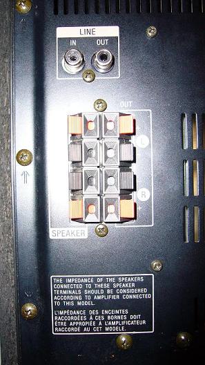

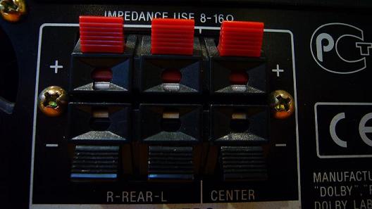

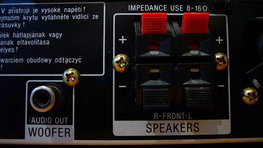

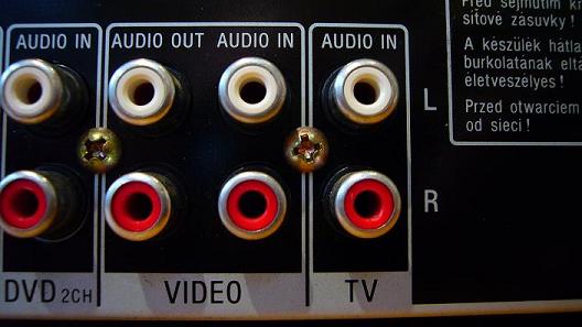

Here are some images of the backs of the unit to help!Upload
Do I need to plug the speakers into the back of the sub, then get a certain kind of wire to connect the sub to the dvd?
HELP!!!!

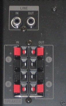

Ooops....here is the sub!
BTW not sure if the amp is working due to it constantly saying 'PROTECT'

Our posts crossed. Thanks for the pics, and they do help. As I said, check the speaker wire for shorts. Considering how close the speaker connections are on the amp, there is a good possibility of a short there.
Hopefully, once that problem is solved, you have another problem to deal with. It seems you brought home an older "Dolby Pro Logic" instead of a modern "Dolby Digital" amp. I sure hope you didn't pay too much for it as I guess it has to be 6 or 7 years old. At least.
Does this amp have a subwoofer line out? I think I see one next to the rear speaker termnals. If so then you hook that output to the line in on the sub. But if this old fashioned amp has no subwoofer line output, the only way you are going to get the subwoofer to work is to run speaker wire from the amp's front two speaker outputs to the red and black speaker terminals marked "in" on the sub. Then you have to run speaker wire from the "out" terminals to the front two speakers.
The sub does not get hooked up directly to the DVD player.
The most likely reason you only heard the front two speakers is that you have to switch in the "Dolby Pro Logic" mode on the amp.

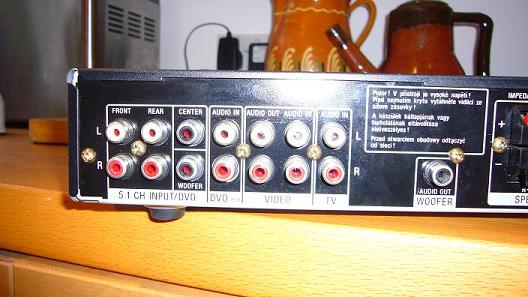

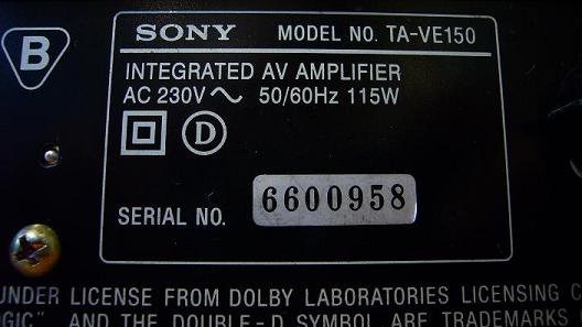

Here are the exact models -
Sony SA-W305
Sony Amp - TA-VE150
DVD player - Umax Kazuki DVD-7400X MPEG4/DivX/DVD
Cable box - Eurovox Max

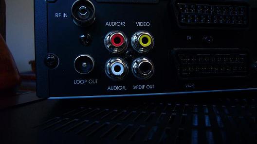

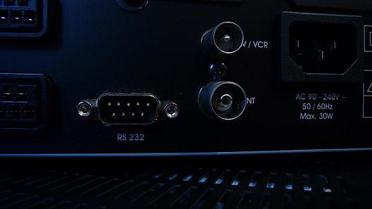

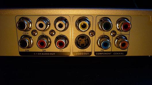

And I took some pics last night.
Would you be kind enough to take a look and see if you could give me some advice on what kind of wires go where?
Sub
Amp
DVD
Cable boxUpload

The diagram on the top of page 4 (titled "adding freeview, satellite and cable") on that richersounds link is close to the right hookup.
"What sort of lead would i need to connect the sub to the amp?"
As you can see on that diagram they call for a single phono lead going out from the "audio out woofer" jack on the back of the amp to the "line in" jack on the subwoofer. If you don't have a single phono lead you'll have to get one of sufficient length.
"I tried connecting via the instructions but can only get sound out of 3 channels. I tested all speakers and they work. I think the amp is buggered."

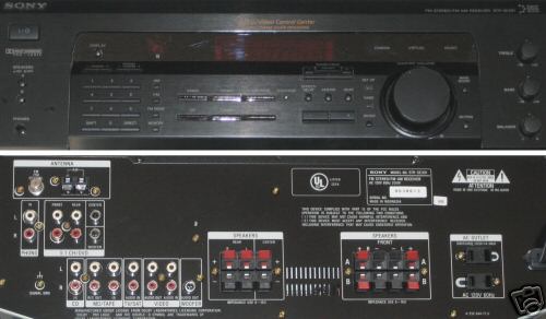

That Pioneer receiver is more modern than what you have. It will do a better job of decoding the digital surround tracks on all DVDs. There is one problem with it however. Its only digital audio inputs are optical, whereas both your DVD player and your cable box have coax outputs (the cable box's digital output is marked "S/PDIF OUT" but that is the same type that's on your DVD player, which is marked "COAXIAL"). There are converters for changing a coax signal to optical, but we needn't complicate your life more than it already is. If you're going to consider another receiver, you need one with two coax digital audio inputs.
Regarding the lack of sound, which speakers are not working? There should be separate volume controls for the center and the two surround (rear) speakers. Have you tried adjusting the volume on those? And what exactly are you listening to when you test the sound?

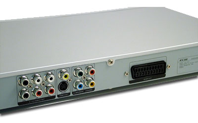

With regard to thw DVD hookup, you need 6 RCA cables. You will want to hookup the multi-channel outputs of the DVD player to the appropriate inputs on the receiver (amp). Specifically:
FR on the DVD to FRONT R (red) on the receiver
FL on the DVD to FRONT L (white) on receiver
SL on the DVD to REAR L (white) on receiver
SR on the DVD to REAR R (red) on receiver
CEN on the DVD to CENTER (black) on receiver
SW on the DVD to WOOFER (black) on receiver--NOT to the "AUDIO OUT WOOFER" jack
All these inputs on the receiver are bunched together over the title "5.1 CH INPUT/DVD"

I'm assuming you are using a scart connector from the DVD to the TV?
Username: Theymademedoit
Bristol
UK
Post Number: 14
Registered: Jan-07
yes.
when you say...SW on the DVD to WOOFER (black) on receiver--NOT to the "AUDIO OUT WOOFER" jack
Then how is the woofer connected to the recvr or dvd?

"Then how is the woofer connected to the recvr or dvd?"
The subwoofer is connected to receiver from the "AUDIO OUT WOOFER" jack to the "LINE IN" on the subwoofer.

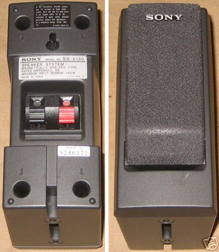

Also is it possible to put 2 speakers into the same speaker port? by this I mean the following -
2 seperate speakers with the following wires
??Upload
into one of the following ports -

In a modern system, the amp generally has the "decoder", and the DVD player simply passes the signal to the amp to deal with (using one cable like a toslink/optical or coaxial).
Your system has a dolby digital decoder in the DVD player, and the amp only has a prologic decoder, but it does have 5.1 analogue inputs to work with the external decoder in your DVD.
DVD Sound Connections
So, to get “5.1” from your dvd, you need to connect the “5.1” analogue plugs between the amp and dvd with the three RCA cables you and John S mentioned earlier. This also means the setup for the 5.1 DD surround sound is done on the DVD player, not the amp.
DVD Sound Settings
You’ll likely need to adjust “distance”, “size”, and maybe “position” for each speaker (again this is done in the menu of your DVD player). On the amp you’ll just need to select “5.1” as the input (as opposed to “dvd 2 channel”, “tv”, etc).
Other Devices Connections
For your other devices, you’ll only be able to connect each of them with the red and white left / right plugs. You’ll still be able to get prologic surround sound, but it won’t be as good as the dolby digital from your DVD player.

Sub at the dvd end going into Sub in on woofer. is that right? one male at each end?
Username: Arande2
400dB could probably d..., SouthWest Mi...
Too Many DBs...
Post Number: 841
Yes, one male end goes from Dvd SW out to receiver woofer in. Then Woofer Audio Out goes to the line in on the subwoofer. Make sure the subwoofer is set as on in the receiver menu (and speakers set as small (probably 120hz crossover). Also, did you make sure the subwoofer works at all?

I will try it tonight. If I want my cable box to work is it just an RCA with 2 on each end? and where do i plug em in?
Also thanks usernamex for your post!
Username: Arande2
Too Many DBs...
Post Number: 859
. Sorry for being late on my response .
Yeah, just hook the stereo audio out of the cable box to the TV input as that is what it is...TV, Right?

I found this.....
http://www.ciao.co.uk/Sony_TA_VE150__Review_5544751

Just 'cause I'm curious...
google: TA-VE150 protect
this guy fixed his, very common problem with these units apparently. It seems the temperature sensor doesn't turn the fan on soon enough, so the amp overheats and shuts down with "protect" error instead of blowing up!
To fix it you need to short the pins on the temp sensor together so the fan runs constantly. "I soldered together the legs of 'transistor QE52'."
Probably take two minutes to solder it together once the case is off. Sounds like there is a 50:50 chance that the excess heat / glowing heat-sink may have melted another couple of solder points. This might explain any other funny behaviour with the speakers cutting in or out too.
first link I saw
This is a sony forum I've used before some info
http://www.agoraquest.com/viewtopic.php?topic=4394&forum=51
Ah, this thread is the money shot (mentioned in the first one). Even if you can't solder yourself, you'll probably get a friend to do it. Hopefully a cheap repair if you gave this info to a repair shop?
http://www.dvd-software.info/forums/ftopic37220.html
