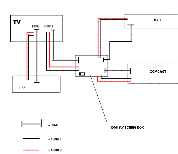

This is Mike who is installing Frank's system. I thought I would clarify some things to help out.
1st. The cable box feeds the pre/pro using a coax digital signal. It feeds the TV using analog audio. The reason for the mini plug adapter is that the LG TV Frank has, only has an 1/8th" mini plug input for that particular HDMI input. It shares the audio with the RGB input which would need an 1/8th" for audio from a laptop.
2nd. The DVD player, pre/pro, and PS3 are all coming from different locations. So, the only scenario that works easily is for the cable box and PS3 to share the same input. Sharing the DVD player is an option, but it requires taking the TV down and running a New HDMI cable to it. I was trying to avoid taking the TV down. However, because of the issue with the cable box sound, it may be my only option. I am going to see 1st though, if the LG TV defaults to the HDMI sound when it senses a signal. In other words will the sound from the cable box automatically get cut off when an HDMI audio signal is present. If this doesn't work than I will go to plan "B" which is running a new HDMI cable to the TV.
I hope this helps clarify the issue. Either that or I just confused everybody!

Username: Thundertiger
Essex, UK
United Kingom
Registered: Jan-07
Username: Hodedofome
TX
Post Number: 18
Hey Mike, thanks for the clarification. If the tv doesn't automatically accept the HDMI audio signal, could you program into your remote to turn off the cable box when you choose to play the PS3? Do you have a remote with macros with that capability? Although I wonder how you would get audio for the PS3 at that point.
Username: Signatureaudio
Registered: Jan-07
Aaron, I could have the remote turn the cable box off, but because Comcast makes such a "great" product it wasn't turning on and off consistently using the IR system. I also thought of muting the cable box but that may not work consistently either. Comcast needs a box that has good discreet codes.
Tom, your diagram would work in theory, but the HDMI switcher we are using doesn't pass analog audio.
