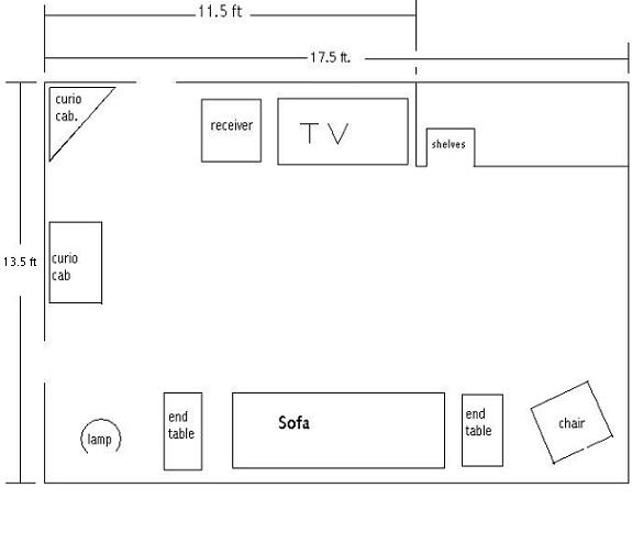

I need advice on speaker placement for my Orb 2 speaker system. Fronts will have to go on ceiling angling down but don't know where to place them. Where to put sub, and center. Rears will go on ceiling also angling down. I am including a diagram of room with approximate layout. Any help will be appreciated.

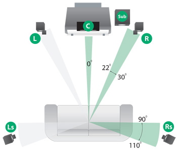

Paul, I'm definitely not a fan of ceiling mounted speakers. The ideal thing is to have the front three speakers as close to the same plane as the picture. But you gotta do what you gotta do, so to make the best of this situation, I would mount the center speaker in the ceiling too. At least the front soundstage would be across the same plane. Sub placement would ideally be somewhere in the front, but failing that you might wire it to the far corner by the lamp. All speakers sould be installed in accordance with this diagram as closely as possible. I wish you luck and I hope you're good at fishing wire through walls.

Ahhhh, sounds like some fun to be had with that install. My recommendation is taking ur entire living room set up and changing it to the length wise set up. goin by width kind of reduces sound buoyancy from travelling. my livingroom is 17x14 ft, i have evrything set up so that my entire living room speaker set up goes the length of room. It your choice of course, but you can also go by what THX describes for proper set up in a livingroom.
http://www.thx.com/mod/products/speakermodes.html
And its usually a good idea to set your center channel slightly behind your left and right front speakers to get a more ambient feel to the living room surround. I wish you luck.

Yea I'm married LOL and the room has doors or doorways on three sides. The diagram doesn't show the door on the right end of the room. I have to work with the diagram. I think I will use wall mounts & floor stands to set the room up as in the diagram John uploaded. Fishing the wires is not that much of a problem. If you have baseboards in your room, you remove them and knock a hole through the drywall. Send an electricians tape through your hole at the speaker location to the floor where you knocked a whole in the drywall. Hook your speaker wire, which should already be through the floor, to the tape( actually it is a wire ) and pull it through the wall to your speaker location. Attach it to the speaker. Put your base board back on and the hole near the floor is covered. Thanks Guys.
