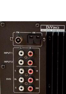

I'm completely new to the Home-Theatre-In-A-Box scene and decided to start of with the most cost-efficient system I could get my hands on.
That led me to the DiVinci DV-607.
Now that I had all the speakers set up I noticed a problem.
My DVD player only had Analog Audio and an Optical Audio Output.
But the DV-607 did not have Optical input. Only six(6) RCA input for surround.
And 2 other audio input for analog.
How am I supposed to get 5.1 surround?
Is there any way around this?
I'm sorry but I have close to no clue as to what to do next.
I am in dire need of HELP!

You are going to need another DVD player. One that has 5.1 or 7.1 analog outputs. The reason it is so cheap is because it does not have any digital surround decoders.

I almost bought one of these systems myself, thought I better surf for more info first. The old adage "If it's too good to be true it probably is" apparently applies here. One note though. The guy selling them on ebay DOES say you'll need your own reciever to operate the system properly because the system is ANALOG only.
Jeremie, yes there is a way. Your DVD player needs to have RCA outs for each speaker. Most halfway decent players will have both RCA and Digital out's.
