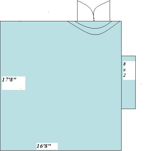

There will be a niche/indent in the shorter wall for the TV till I can save up to get a proper entertainment center built.
What I like to know is based on the speakers I have, where should I place them in the room. Also where should I have the wiring for the other speakers for the future.
Its a room that is 17'8" x 16'8". Intend putting the niche on the shorter wall or I may extend that room by 3 ft ( makes the room 17'8 x 19' 8)to accomodate a niche. I could do with out this and maintain a straight wall - your input on this?
I would really appreciate your input and expertise in helping me get this set up. Would like to know the location and the height at which each speaker wiring should go and what kind of speakers would you recommend for the 7.1 (Floor standing or wall mounted)
I have a pair of each of JBL HLS 620 and 615, would this work to make the room 7.1 or should I save up and get some better speakers?
I've attached a sktech of the room if that may help.

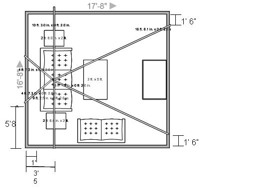

What I have designed based on your feedback as well at a site I found on this forum.
My only concern will be the left/right and the rear surrounds and the heights to place at. I was going to go for a 6ft height on the sides and rear - what do you think.
But as far as angles I found the following at http://forum.ecoustics.com/bbs/messages/34579/129023.html
1. Front - between 22-30 degrees each
2. Sides - directly at 90 degrees
3. Rear - 135-150 degrees
Only thing I heard is that THX wants the distance to be equally spread apart for the rear speakers - diatnce of wall to speaker 1= speaker1 to speaker 2 = speaker 2 to wall 2
Not sure which way to go - but I am planning on going on the suggestion of the forum.
I think I will wait and invest in another set of FX5's rather than use the JBL's.
Below is the diagram on how I intend placing my speakers to get the optimimum angles - just need to get the optimum height - which I may use your guidance.
