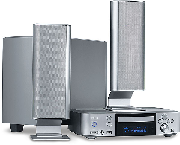

I have a Samsung P5685W DLP HDTV and a Denon S-301 HTIB.
While the Denon manual appears to be quite comprehensive, it is also quite confusing. The instructions are so poorly written that I have been unable to figure how to achieve maximum quality audio and video. Since this is my first home theater set-up, I need all the help I can get! At least I have the system up and running at the basic level, but I figure I should be able to get even better results. Should I purchase an HDMI cable? I presume that would be the best way to go, although I'm not sure. I'm simply interested in doing whatever is necessary to get the best possible sound and picture from my system.
Also, how do I get TV/HDTV audio to play through my Denon home theater system? CD's and DVD's play just fine thru the S-301, but so far I've had to rely on the TV speakers for TV programming. I figure there should be a simple way to set this up.
I would greatly appreciate hearing from anyone who may be able to help me. Thank you very much.

Sorry to see you're still having trouble with audio from the cable box. Some things:
1) Are we sure the optical output on the cable box is active? Is there a red beam of light visible on that output when there's no optical cable hooked up to it?
2) Is that optical cable hooked from the cable box into the Aux 3 input on the Denon? This is the only optical input available. Obviously, the cable should not be hooked into the optical output, which is right next door to the Aux 3 optical input on the Denon.
3) Your audio input mode should be set to "Auto". This insures the Denon will detect any digital signal on an input first, and failing that, will look for an analog signal second. The Audioholics diagram recommends using both a digital hookup as well as using regular R/L analog wires in case some of the cable channels audio are not digital and some are. (This was the case on an old cable system I used to have, where channels 2 to 100 were analog and channel 101 and above were Dolby Digital.) There is a set of R/L input jacks marked "Aux 3" to the left of the digital inputs.
To make sure your Denon's audio detect is set to "Auto", go to System Setup Audio, then scroll down to "Input Mode" and enter the "Auto" option.
4) To state the obvious, you must then select Aux 3 by hitting the Aux button on the remote (near the top) until you see Aux 3 on the Denon's display. Select a premium HD or movie channel on the cable box and turn up the Denon volume control. If you don't have sound after all this, I don't know what else to suggest!
Good luck. I admire your patience. :-)

Even though I'm happy to report that I'm finally getting the TV audio to play through my new surround system, I still have a couple of questions for this forum regarding the connections I've made. Perhaps I've even made some unnecessary connections.
I have a yellow Video cable connecting the cable TV box to the A/V receiver, then another yellow Video cable running from the A/V receiver to the television. I also have the HDMI and Fiber Optic cables connected, so maybe I'm already getting the best audio and video possible.
My cable TV receiver doesn't have an HDMI jack, so the HDMI cable is connected from the A/V receiver to the television. Perhaps I would get better results if my cable TV box had HDMI input/output capability so all three components could be inter-connected.
I have Y/Pb/Pr Video cables running from the cable TV receiver to the television. The Component Video Out Y/Pb/Pr Out jacks on the back of my A/V receiver are NOT being used. Does it make any difference HOW -- or even IF -- I have these particular cables connected?
The most confusing thing at the moment is figuring out how to use the new DENON A/V remote in conjunction with the Motorola/Comcast remote and the Samsung TV remote. I hope I'll be able to program the DENON remote to pretty much control everything.
Username: Kozakid
Post Number: 9
Registered: Dec-05
John,
Thank you very much for your reply! I didn't read it until after my recent post.
There IS a red light showing inside the optical output, which I presume means the output is active.
The optical cable IS hooked to the Aux 3 optical input on the Denon
It took a little while to figure out how to do it, but I just checked my audio input mode; it is already set to AUTO, which I figure is the default setting. I also made the R/L analog connection, which I figure may not be necessary. In fact, from reading my most recent post you may be able to determine if I've made any improper or unnecessary connections. However, since I'm now getting sound -- and it sounds quite good to me -- I figure there's a good chance the set-up is as it should be. Of course, I'm open to any suggestions which may improve what I already have.
I do have one complaint remaining, and this one pertains only to DVD video. Roughly every 30 minutes or so my screen will suddenly turn black, but only for about four or five seconds when it then returns to normal. This sounds very similar to the following problem described by a customer reviewer at CNET. Here is a portion of his review:
Cons:
Frequent loss of picture. It's going back because of this.
Full user opinion
I am having a problem with my Denon which I bought last week. on average, every 30 minutes or so, the picture cuts to black for 5-10 seconds. The sound remains, but suddenly there is just nothing on my tv screen.
I'm taking this back to where I bought it because of the glitch. Hoping it was just a faulty model.
(End of review.)
Do you have any idea what might be causing this problem, and, if so, how I might be able to correct it? Could it be something as simple as a loose connection?
I really like the Denon S-301 and would prefer not to return it to Best Buy, but if this picture dropout problem persists I may have no choice. If I do end up returning it, I would then definitely upgrade to a true -- and more expensive -- surround system. Price is one of the main reasons I'd like to keep the Denon, but I'd be willing to spend the extra bucks if that's what it would take for me to be satisfied.
Thank you very much for your help, John!
Sincerely,
William
