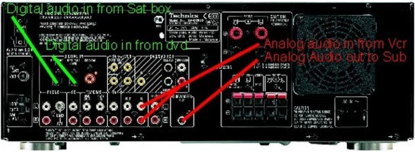

After finding a pic of your Receiver, I see it doesnt have s-video switching, most unfortunate.
In this case you will want to hook your equipment up as follows:
Component Video out of your DVD to the component video input on your TV. component video cable looks like this:
Hook up your Sat box to your TV's rear S-video input.
Hook up your vcr to your tvs rear composite video input (single yellow cable over or under the red and white ones)
Hook your audio up to your receiver as in this diagram:
