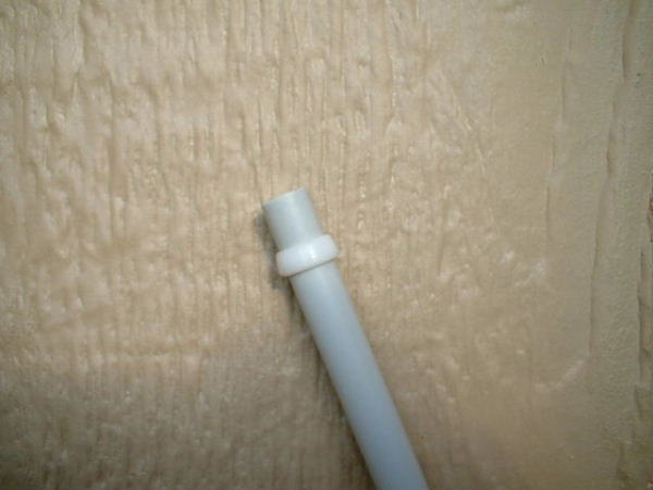

I have recently spent 2 years busting my butt completely gutting & renovating our home and was 95% finished. My last project was to create a new, dedicated HT room downstairs. It was a completely unfinished room, so this involved everything from new walls, drywall, insulation, wiring, conduit, lighting, crown & baseboards, primer/paint etc. I was just getting ready to have the carpet installed.
On June 9th, I was out for several hours and returned home to find the house half destroyed by water from a plumbing failure in an upstairs bathroom. This of course included a portion of the new HT room. After the amount of work involved to the house, this has been devastating. Insured? Yes, but enormously disruptive just the same........new hardwood floors ruined too.
My point is this: Look in your bathroom and kitchen cabinets, and at your toilet supply lines. If you have any of those grey plastic supply pipes that run up from the shut-off to the tap, get rid of them! I have since learned that these fail on a regular basis, and a BRAIDED STEEL line is the only way to go. It's cheap insurance, and I would have paid many times their price had I known.

aye, steel braid clad water lines are available on the market now, rubber hose encased in a steel braid, as the name suggests.
Prevents any buldge ruptures or physical damage to the water lines. totaly worth the 20 bucks a hose.

The line itself rarely, if ever fails, and in regard to the grey plastic line that I was refering to, it's bomb-proof it's so tuff, but it's the retarded compression fitting on the end that is the problem. (thanks a lot designers and CSA for approving these time bombs - I hope your homes get destroyed by water).
