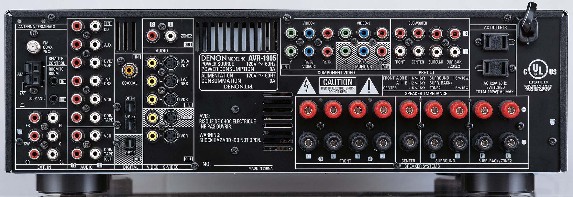

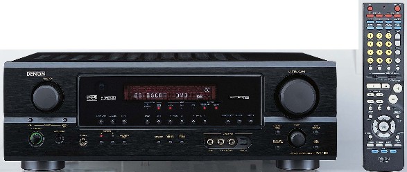

if you are limiting yourself to a HTiB then your pretty much gonna have to take whatever they give you.
You may want to buy in inexpensive HT speaker package and put a little money into the receiver so you can just upgrade as time goes on
You want a receiver with Component Video Switching, Video Conversion, assignable digital inputs and throughputs, and high quality D/A converters.
You can get most of this as well as discrete IR commands for a programable remote in an entry level model to a higher end line.
I personaly recommend the Denon 1905 for this at a suggested retail of $499 US.

Regarding the VCR:
In a receiver like the denon 1905, or any similar, the VCR input is adjacent to the record loop output.
Right next to where you plug video and audio from the vcr into the receiver, you can plug a loop out to its input.
From this loop your vcr will receive audio and video from any source you currently have selected on the receiver.
You can also run an RF loop (coaxial cable) (cablevison thread on type) out of your hi def cable box into the vcr, so you can set it up to record a specific channel, (or use VCR+ codes) to record the channel while away from home without the system being on.

--"In a receiver like the denon 1905, or any similar, the VCR input is adjacent to the record loop output.
From this loop your vcr will receive audio and video from any source you currently have selected on the receiver. "--
Ahhh... I see. I did not know that. Makes sense, I'll know now to look out for that feature.

Most of these you see have component video switching, not conversion, meaning you have to run both a component cable out to the tv AND a composite cable and switch inputs on the tv depending on whether what you are watching is being fed into the receiver on component or composite.
Thats why video conversion is such a nice feature, you're not constantly having to switch inputs on the tv.

Shawn - "Re: "ignoring the receiver" due to video quality degredation... so you are connecting the video (component I assume) directly to inputs on the TV, and the audio to the receiver?"
You are correct.
In my own HT system I have a HD satellite system which sends component video directly to the TV's Video 1 input.
The VCR is connected to the TV via a composite cable to Video 2.
The DVD player is into the TV's Video 3 connection by way of component cables.
Video 4 has a composite cable from the receiver exclusively for the menu operations of the receiver which require a TV monitor for set up.
A cable is run from the TV audio out to the receiver in case I need to use the TV's tuner for anything.
The outdoor antenna is into Antenna A in case of an outage from the satellite during a storm (only used to check whether the local broadcasters are telling me to take cover) and also fed to the satellite box for local HD programming. (Just for clarity, both satellite and antenna come in through a substantial surge protector. This is an indispensable piece of equipment.)
All audio inputs from these sources are run directly to the receiver/processor.
My TV allows me to turn off the inputs I don't use so, all total, as I switch between inputs I toggle only through (3) inputs I have designated to be live connections (SAT/VCR/DVD). I use a universal remote which allows three macro settings. Macro settings are combined commands that operate in sequence at the push of one button. They are programmed to be any sequence the operator desires. The remote cost me $49.
The first macro switches on the TV; switches the TV to Video 1 (satellite); switches the receiver to satellite input for audio; takes the receiver off mute (my receiver stays on 24/7 unless there is a storm) and finally places the remote in a position to direct commands to the satellite receiver. I am watching and listening to satellite programming with the ability to change channels. The remote's volume control for the receiver is on an override ("punch through") so it will always adjust volume even when the remote is set to satellite or DVD. Pushing this button again turns off the TV and returns the receiver to mute. This works because the TV power and receiver mute functions are the same electronic command to toggle on or off.
The next macro button toggles through the inputs on the TV until it reaches Video 3 (DVD); sets the receiver to DVD audio in and sets the remote to DVD commands. The final macro goes back to satellite functions on the TV, receiver and remote. Since I hardly ever use the VCR any longer, these three macros do what I actually need 99.9% of the time. If I had two more macro commands, I would set them for switching for the VCR. I don't have them but also don't miss them.
That's how I have my system connected.
In other systems I've done otherwise. As HT systems become more complicated, the ways to connect the systems also increase. If I feel a client requires a simpler or more complex system connection, I'll run video through the receiver if it doesn't compromise the video quality.
Part of your desire to learn the multiple methods to make a system go together will be thwarted by the multiple ways a system can go together. As an installer I have to know the equipment and the customer's usage. Then I plot the best method to get from point A to point B. Though it's an over simplification, no two systems go together exactly the same because no two clients have exactly the same situation.
Audio and video loops are available on every receiver to use as directional road maps. Switching audio is fairly basic and any receiver can manage that function. Switching video is far more complicated for many reasons and not all receivers can manage the job well. To make matters worse, the industry is constantly introducing new connection points (HDMI, composite, optical, digital, etc.) which allow the manufacturer to market new features. In some systems these features allow a simplified connection through a minimum of cabling. In other systems the amount of connections increases (needlessly in my opinion).
I prefer the simplest, most direct route for all the signals. Whether that is accomplished through HDMI or a composite cable to the TV is a matter of what system I am connecting.
I would suggest you plan out the amount of ins and outs you think your system will contain in the next five years. Look for a receiver which can handle that plus one. By the time that receiver no longer fits the bill, you will be readly for the new features the industry has planned for tomorrow.
Username: Mothman
Post Number: 8
Registered: Jun-05
You guys have been great! Thanks for your patience.
Jan, your latest post was very informative... I sometimes can understand things better if given "real world" examples, and yours did it wonderfully.
Michael:
Re: "...meaning you have to run both a component cable out to the tv AND a composite cable and switch inputs on the tv depending on whether what you are watching is being fed into the receiver on component or composite. "
Hmm. I can see why video conversion is such a great feature.
Say a person had a DVD and cable TV each with component video going to the receiver. And a gaming console with s-video going to the receiver. And a VCR with composite going to the receiver.
Am I understanding correctly that if the receiver was NOT capable of video conversion, that person would have to run component video out from the receiver to (for example) the TV's Video 1 input... and run s-video or composite out from the receiver to the TV's Video 2? [seems to me that most receivers I've looked at only have the two video outs (one component, one composite/s-video)] And then the receiver would "decide" for itself which video output to use, based on what it is getting sent through it?
So in this case, the DVD and cable TV (component video) would automatically be "routed" by the receiver to the TV's input 1, while the VCR (composite input) and gaming console (s-video input) would be routed by the receiver to the TV's input 2? Meanwhile, I would have to manually tell the TV which video input to watch.
I understand that I may be better off wiring the video sources directly to the TV, but I'm just trying to understand this other way (not to mention the TV likely may not have enough video inputs for all of those components)
Username: Daedilus
Post Number: 134
Registered: Jun-05
aye, you are correct, you would have to manualy switch inputs on the tv without the video conversion.
With the video conversion, all sources would come out of the component video output.
Another plus is that you can run multiple extended definition sources to one input, say your hi def sat box and your progressive scan dvd, and the tv will sense and format to whatever you are sending it without having to have a second component video input used on the TV.
Username: Mothman
Post Number: 9
Registered: Jun-05
Isn't your last paragraph the same issue?
DIfferent video formats going into the Receiver, which is converting it to a single format?
One thing I hadn't considered however, is that the DVD may be different from the hi def sat/cable in regards to the video format.
Username: Daedilus
Post Number: 140
Registered: Jun-05
Yes, it is, your DVD is putting out Progressinve Scan 480p
Your Cable box is putting out Hi Def 1080i
The amp will pass whatever "Native" component video format is sent to it, in addition it will take in non component sources, such as NTSC 480i from your VCR and game cube, and convert them to a 16:9 aspect ratio (meaning it will stretch them to fit the screen), and send them out to your tv using the same component video cable.
My main point is showing the tv is auto sensing the format coming to it from the receiver.
All of your programs can be viewed in the correct format using one cable, without having to pay for the added cost of that second component video input being located on the tv, or the madness from swapping aspect ratios constantly while changing between sources.
