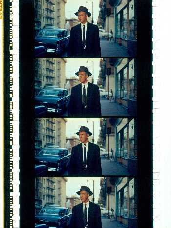

Star Wars was the word and more cinemas where installing Dolby CP-50 units and CP-100 for the road show events like 70mm six-track magnetic sound with A Type encoded on to the full spectrum uncompressed magnetic tracks, with a frequency range from 30Hz to18KHz better than most and still is the best sound around unlike Dolby Digital which uses compression to fit all the six-full range channels in-between the perforation near the sprocket hole on the 35mm film with other Digital sound formats like dts which as a pulse coding looking like Morse code.

Also the “CDS” cinema digital sound was the first true sound for the cinema industry and the sound was encoded onto the film print full six-track spectrum sound, this came around in the early1990’s and lasted for a short while due to not being backward compatible and Dolby took over with there own digital format that is yes still around,
