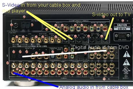

G. Dark
Unregistered guest
Thanks for the tips. I'm getting both sound and picture, now. But this is weird: I have a set of component wires (red, white, yellow) running from the TV to the receiver. I also have an s-video cable running from the TV to the receiver. The only way I could get a picture was to hook up both. If I unplug EITHER ONE, the picture goes away.
What's up with THAT?
Username: Daedilus
Post Number: 44
Registered: Jun-05
If you are using basic cable from your tv's video monitor out to the receiver then you dont need it, sounds like you have a loop ran.
If you are using a cable or sat box try hooking up as in this diagram:
This is the proper configuration for your older tv.
If you are not running a cable or sat box then run the audio from the monitor out of your TV to the Tv analog audio input where cable box is shown to go now.
