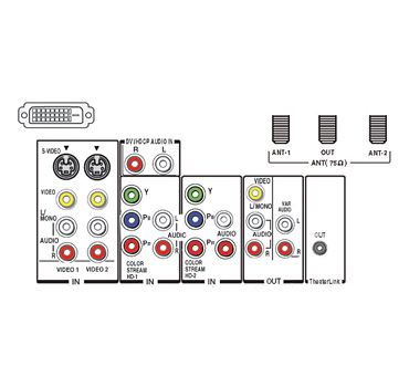

Username: Ejgali
Manalapan, NJ
Usa
Registered: May-05
In the diagram (Plasma TV jackpack) where would I connect the Theater system audio to? (Theater System has a range of inputs and outputs including: 1 optical digital, 2 analog and 2 composite video input connections along with 1 optical digital, 1 analog, 1 composite and 1 S-video output connections.
Cable set-top audio (has a digital audio output jack) Upload
Username: Dmwiley
Post Number: 645
Registered: Feb-05
Are you attempting to play your tv through your receiver or the other way around?
Username: Ejgali
Manalapan, NJ
Usa
Registered: May-05
Dale,
I'd like to have an option that allows me to use the TV sound system at night when the kids are sleeping and also thru the theater system when I want...Does this make sense?

Username: Daedilus
Post Number: 116
Registered: Jun-05
Rick
The answer is no.
If you want both HT audio and standard internal tv speaker audio, then you need only run and RF (cablevison) wire out of the HD cable box into the TV's Vhf tuner in addition to your digital hookup to the receiver.
When you want HT you can switch the tvs input and turn on the receiver and have HD tv and DTS sound.
When you want regular tv and lower volume you can simply turn the tv to channel 3 (or 4 whatever channel your cable box displays on), and watch standard definition tv through the tv's speakers.
