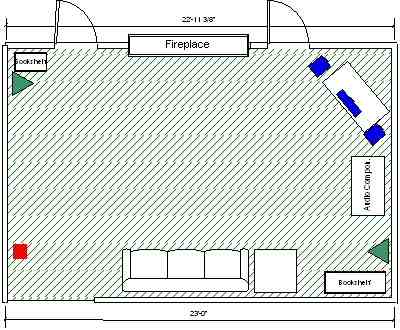

Hi -
I have a pretty tough room layout, that I'm trying to set up for both HT and good music listening. In the attached drawing, listening position is on couch, TV is in corner - with front/center speakers shown in blue.
Possible location for wall mounted side speakers (maybe dipoles?) shown in green.
Possible location for rear surround shown in red (or maybe just use sides here and ditch the green ones, ie bag 7.1 and go to 5.1). Thought these would need to point up or point backwards at wall.
Both short walls are almost entirely windows. Rearranging furniture not an option at all.
Would appreciate suggestions on side and rear surround, as well as honest advice as to whether this is too non-ideal to make it worth trying for 4 surrounds.
Thanks,
Michael

Michael,
Based on your stipulations above, your surround locations are about as good as any. As for the rear(since the layout is off kilter), I'd put the back speakers closer together. Maybe within the width of the couch and wall mount them pointing downwards. And yes, it's still worth having surround, even if you cant do it by the book.

Thanks Paul-
Would you suggest just using one rear speaker centered above the couch?
Would you recommend diffuse (eg dipole) speakers for either rear or side, or go with direct radiating? Would you move the left surround towards the other long wall - or would having that forward of the couch make it worse?
Finally - given that my listening is 50/50 music/HT, does that change any of this?
Thanks!
Michael

Michael,
Sure, one back speaker centered would work just fine. Whatever you prefer. My preference would be to use two even if they were close together, but that's just me.
As for dipole.......that's mostly preference too. If your surrounds are pretty close to the back wall, I probably wouldnt. I dont think dipoles are their best if they're backed too near a corner. Im sure somebody will pipe-in and say otherwise though........LOL
50/50, 100/0, or 0/100 doesnt really change anything as it relates to speaker position because you're trying to achieve the same thing with each, and that is filling the room with sound. Your audio sources will effect speaker selection though.

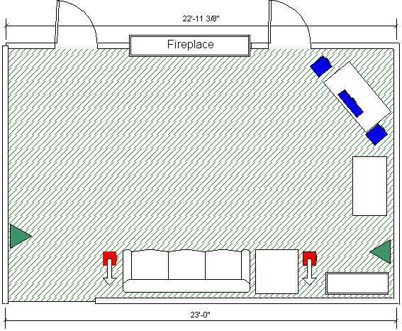

Username: Jasperm
Post Number: 16
Registered: Mar-05
How about this alternate arrangement - worse or better than first?
In this arrangement, I lose the two rear speakers on the floor pointing up, and replace with one more distant, wall mounted "sort of rear" speaker, while spreading out the side surrounds.
If you ignore the orientation of the couch, it sort of makes sense.
MichaelUpload

Uhhh....gee - that was entirely unhelpful. Not trying to have a movie theatre in my livingroom, just a decent approximation of surround sound, for music as well as HT.
As an expert, could you suggest which of the two setups I posted would work better? Those really represent the range of my options. Other advice, especially involving demolition or scads of speakers, is really not useful - but thanks anyway.

I'm probably going to end up going with Mike's second drawing there (without the red rear back speaker). Anyone want to chime in with serious comments on where you'd put the surround sound speakers there?
