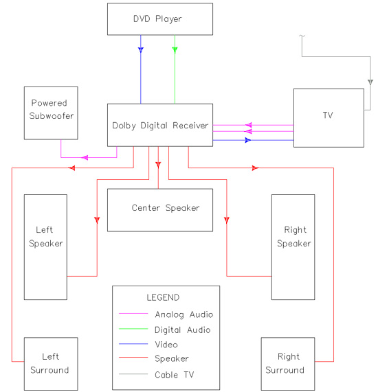

Username: Sundog2000
Registered: Dec-04
Thanks for the direction.
I think that this image is a good display of my setup: http://forum.ecoustics.com/bbs/messages/3/113705.jpg except I also have a VCR between the cable and TV (with lines running from the VCR to the receiver as well. So I feel like this reassures me that I have done the cabling properly.
Any further suggestiosn?
