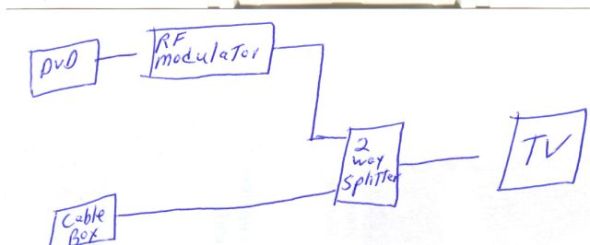

I am trying to hook up a dvd player with an RF modulator and a A/B switch along with a digital cable box to my tv. Could some one email me and tell me how to hook them up so everything works please? thanks.
notorious av guy
Unregistered guest
Ok Terrie
Easy solution: most modern rf modulators have an auto detect circuit whereby if it senses the video sync from say your DVD's video output, it'll AUTOMATICALLY do the switching for you - pretty cool eh, you don't have to manually switch anything.
Hard way: (since ur using an rf mod, I assuming you just have a coax plug on the tv and that ur tv lacks av jacks) Take your cable box's rf/coax antenna output and plug it into "A" of the a/b switch. Now hookup the audio and video from the dvd to the rf mod...then take the coax out from the rf mod and plug it to B of the a/b swtich.
Lastly take the TV out of the a/b switch and plug it to the TV. Set everything - rf mod, cable box channel output, and the tv itself to channel 3
A = cable
B = DVD

I'm setting up a room for home theater and need to separate the AV receiver and DVD from the TV by 30 feet. Is this even possible given the cable length limitation of 75 ohm cables?

exactly the same problem as mine.
I have a sony tv vcr combo. In the back there is only a cable input. I
decided to hook up a dvd player to my tv. Radio Shack told me all I
need is a rf modulator. I do not have a cable box only an ab cable. I
took the cable and ran it to the rf modulator and then ran a coax to
the tv. I hooked up the dvd player wires (tried both the red white
yellow wires and also the s-video) to the rf modulator. The tv works
find. When I turn the dvd on (tv is on channel 3) there is no picture
or sound for the dvd player. Any suggestions, please post/email me
(tomcics@yahoo.com) thanks.
Username: Jdsaenz1
Post Number: 101
The wiring (at least from A to B, etc.) sounds right, but I'm wondering if a cable or two are in the wrong spots.
Your coax cable from the wall is going into your rf modulator ('cable in', or something similar). The dvd player's audio and video are also going to the rf mod. Just make sure that the rca outputs from your dvd(yellow, red, white) are correct; they should match the rf mod. If you're going with s-video from dvd to rf mod., the stereo (red, white) cables still remain the same (dvd audio out to rf mod's audio in).
So, your coax cable and your dvd are being input to the rf mod.; now just make sure that the rf mod to the tv ('Out to TV' or something like that) is connected to the tv like it should be.
Last, but not least, if ch.3 isn't working for you, have you tried ch.4?
Can't think of anything else that would cause the problems; hope this gets you some results!

question the cable that you use for cable it it coxial cable ?????????????
question how old is you tv, and does it have the RCA plug on back that the 3 red yellow and white one ????????????//
never for one thing will you get the dvd to would on a older tv with out the A/V RCA 3 color plug red white and yellow, it just will not work
dvd do not work on older tv, but there is a work again you need a RF Modulator
it work like this it connected from dvd to RF Modulator useing the 3 RCA plug. from there it covert it to a coxail cable which you connected from RF Modulator to the tv or in you case vcr then tv and it should would

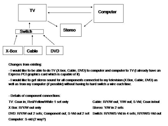

Please help.
I am trying to go from a tv-cable/game/dvd configuration to a tv-cable/game/dvd to/from computer all to stereo configuration. The two problems I am having are listed on slide 2 as well as the connection types of each device.
I HAVE SCHEMATICS - but I can't get them under 1Kb to post them (please email me:: jamesacoberly@yahoo.com)
Can someone please tell me what hardware I need and what I need to to get this to work with the following priorities:
1. least amount of hard (wire) switching during use
2. best quality
3. least wires / switches
Thanks,
JC
Username: James_c
Registered: Jan-05
Trying again with schematics:
Image 1 is current
Image 2 is what I am trying to do
Username: Dirtfarmer

James C
for one thing if you are trying to connect a compter you are going to have to get a a tv tuner, to recive and form of feed from tv or to a tv
Username: James_c
Registered: Jan-05
Hey. Just the guy I was looking for. Thanks for answering.
I've got ATI's multi-media service center. I can do a one way feed from TV to computer, but I was hoping to reverse that feed as well.
Also, I'm having trouble getting more than just the DVD to get stereo sound. Is there a such thing as an audio only switch? Is there a way to do it with wiring alone (no switch)?
I actually did look at every single one of those schematics on the other forum that you guided me to, but none covers it.
I think my problem is that I am using a mix of next gen technology (dvd, computer, cable box); slightly dated technology (tv), and completely dated stereo.
Any advice (besides "get a new stereo")?
